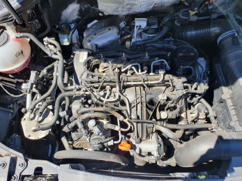

Hi, I'm posting here instead of the Q3 section given that it'll be the same engine, and hoping for a wide audience.
My wife owns a 2.0tdi 140 which has recently started flagging a flashing coil on the dash intermittently which sends the car into limp. Turning the engine on and off solves it temporarily, but it seems to be getting more frequent. Reading into this I've seen all sorts of responses from the actuator connector to a new turbo. My plan is to pull the inlet off and clean it... After 130k I'm sure they must need doing, along with the EGR. Is there anything else I should be looking at that you guys can point me in the direction of?
Also, where is the EGR on these?
Thanks in advance for any help.
Tim

Not much help, but have you had that emissions software 'fix' carried out?
Only thinking, I have a 2.0tdi 140, & looking through the history it had the emissions recall carried out & then following on from that the previous owners had a new EGR valve fitted. I've since read that whatever that 'fix' does also makes the egr work harder & possibly causes them to fail. No idea if that is correct but sounds plausible.
Do you have a code reader of some sort? might flag up an error code to point you in the right direction.
One other thing, does it go into limp mode when you are doing anything in particular? as an example, my pd130 a4 sometimes goes into limp mode when i rev it hard & this points to sticking vanes in the turbo. But if yours just flashes a warning light & then goes seemingly at random i doubt it's that.
Just a few things to add to the mix.
As for the location of the egr, correct me if i'm wrong but i think it's down the back centre of the engine. My mrs has the car at the moment or i'd have popped the bonnet & had a look for you.
Reactions: 1animal1
I had this very problem. I would first stick in a diag tool to see if you get a code relating to the EGR. In my case I had the diag code relating to the EGR but it turned out the DPF was no longer regening. Theres a few ways you can have the DPF cleaned.
If you've got a CR140 (common rail) (>2008-2012) then it'll be underneath the turbo, next to the DPF.
Reactions: 1animal1

I should have mentioned that's it's the CFFB engine. I've since taken it for an Italian tune up which seems to have gotten rid of the warning lights and limp mode for now. I do however have a permanent EGR code P040300 which indicates a circuit issue with the EGR. I'll be checking the EGR connection later and maybe the actuation of it by getting the diagnostics to open and close it. I'll also be removing the inlet to give it a clean.... Time hasn't been on my side with this having a poorly new born. I'm still to find the EGR actuation valve that used to be mounted on the inlet... I can see the shudder valve but not the valve that opens the EGR to the inlet.... That used to be an obvious dirty area on other cars I've had.
Emissions fix. I'm not sure if this has been done... I called the dealer last week and they confirmed no recalls. That'll probably need another call to confirm this point.
Hopefully with it being a Q3, it'll be A bit easier to get to the EGR if I need to remove

You’re 2004 vehicle cannot compare with these common rail engines which have the egr buried away. Just test the egr with W vacuum gauge, faced many with failed diaphragms.
if you have a diesel 2.0 BKD etc it takes 15 mins to change the egr, second hand OEM are about £20.
As above, these are totally different. You need to remove the sub frame to get at it. I've been quoted by two mechanic mates... £395 and 430. I can get it mapped, egr software wiped and dpf gutted for £300. It's the wife's car so not bothered and speed.

I've booked it in now for the EGR. Yes this could get messy, especially if there are other factors like exhaust sensors etc stopping it regenning... But knowing that we could/will eventually have a particle test on the mot... The cost of undoing all this would be a fortune - and of course I don't want to be passing that onto the next owner. Truth be told I'm not sure how long we'll have this... I might have to upgrade her to a Q5 soon on account of the kids‍♂️

@1animal1 If you're going to replace the EGR valve + Cooler. It isn't the cheapest repair, mine set me back £750 with genuine audi parts.
I managed to get a mate to replace with a Pierburg, which I believe are OEM. £400.
That said, I now have the common judder issue around 1500-2500 revs. Had a forced regen carried out leaving no soot... It's still there
