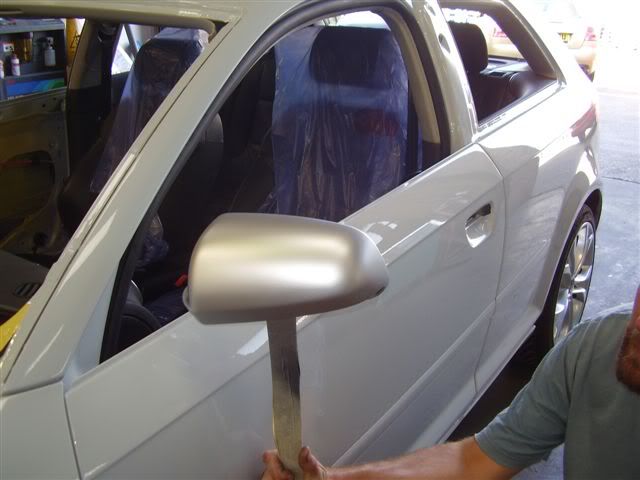

I bought chrome mirror covers like an idiot when the s3 mirrors are brushed aluminum! So those are going back to Germany. Meanwhile, the mirrors you see below were actually the OEM's sprayed with special paint. They are not too far off imo, they may just need a little 'de-matting'.
