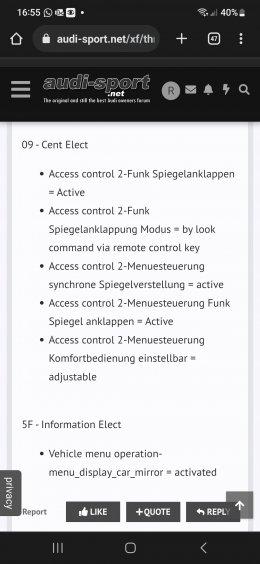

Coding is in the earlier part of this thread. Pfl is done through coding and fl cars is through adaptations. Can’t remember them off the top of my head but it’s there somewhere.
