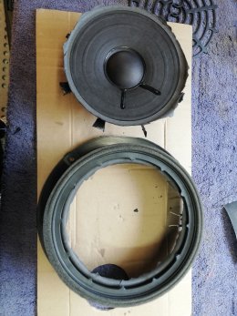

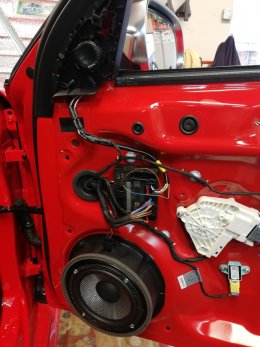

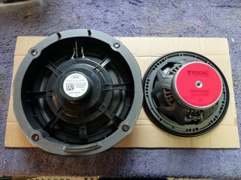

I'm currently in the middle of replacing all of the B&O crappy speakers in my 2015 S4, standard are really cheap paper cone type with a B&O sticker on them.
Dash Mid range speakers (left/right and centre) are done as are both front doors (165mm woofer + 1" tweeter) which has made massive improvement over standard, I'm now in the process of changing the rear door speakers (the same woofer/tweeter as the front) then on to the rear deck mids.
I'm replacing all the speakers with Focal 165 AS3 component speakers and modding the standard speaker mounts to keep it looking factory, it means being brutal and cutting away the old speaker from their mounts etc.
Once I've completed them all I'm going to do a post explaining all with step by step pictures.
A couple of photos to show what I mean.
Yep Im doing the same the speakers are the cheapest crappy ones from the parts bin,no way B&O had anything to do with these.For the fronts did you go with a crossover for the tweeters or use a capacitor,Im having trouble finding somewhere to put a crossover?I went with Audison Voce speakers and also added a seperate amp/bass speaker in the boot as the standard one is useless .
Andy Butcher
I also found no where to fit the crossovers and I guess (hope) Audi have separated the frequencies in the system, well that's my thinking.
The standard B&O tweeters have a 4.7 ohm capacitor on them, so I unsoldered them and reused them in-line to the new Focal ones.
I've completed the doors and dash speakers and now working out how I'm going to mount the rear deck Mids, I don't need to do the main Subwoofer as I did that around 18 months ago.
Hangn
As I thought, I made a polystyrene mock up of the crossover I wanted to use and the only place to put one is under the dash which would require hacking into the wiring pre door connector .So I will look to add a couple of audiophile quality capacitors for the tweeters dont fancy hacking into the factory wiring .
