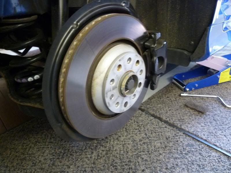

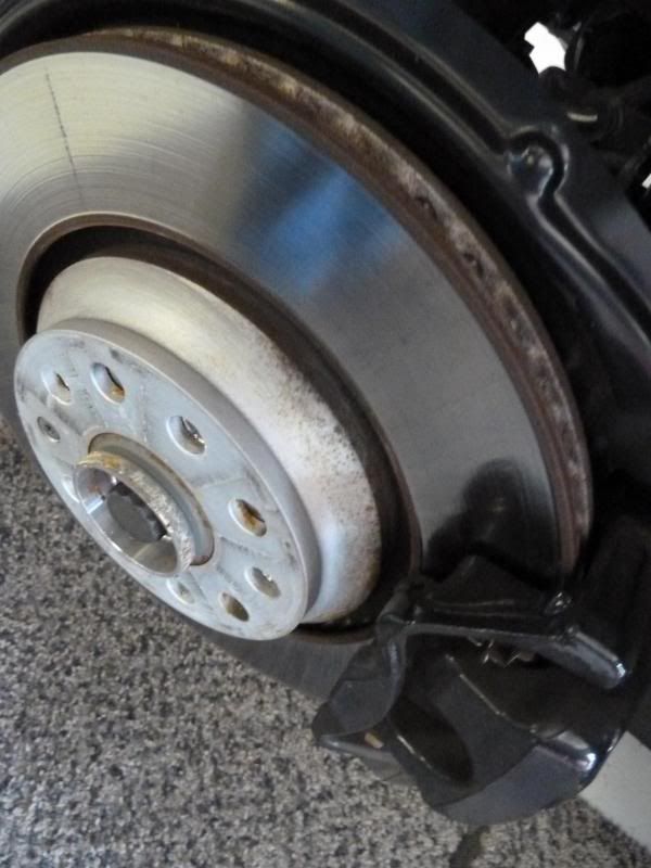

Spent the afternoon with John 45BVTC as it was time to sort out those yucky looking rear hubs!!
Before.
[/URL]
[/URL]

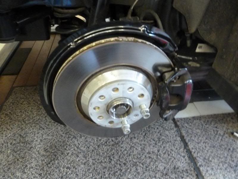

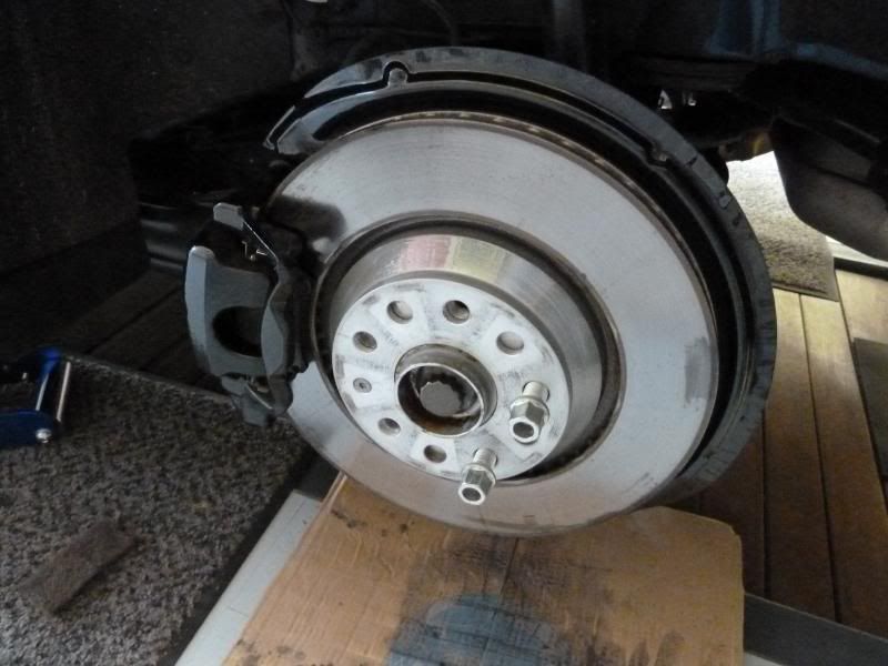

After rub down, clean and a coat of clear POR-51
[/URL]
[/URL]

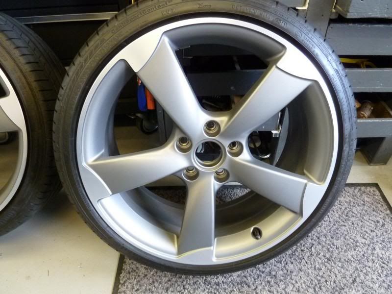

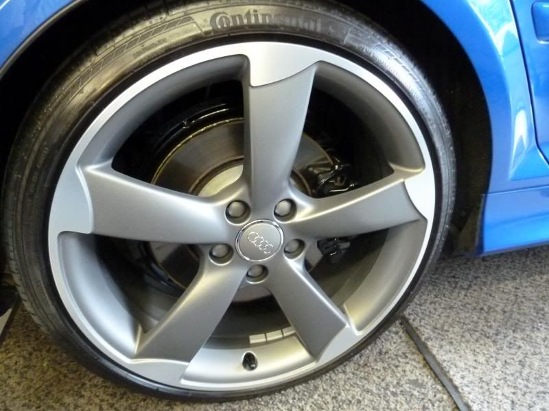

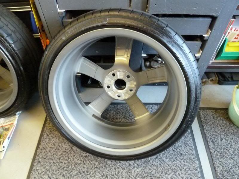

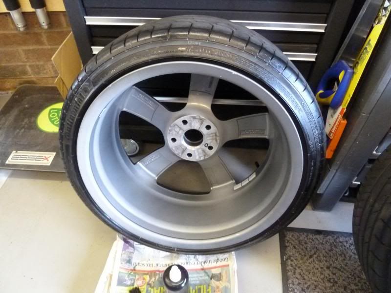

Wheels also cleaned and protected.
[/URL]
[/URL]
[/URL]
[/URL]

Here's where I lift Marcus - and for others:
At the FRONT and in-line with the detent in the sill:
and at the REAR again in-line with the detent in the sill:

Ref: "the circular rubber piece is the jacking point" :think:
I don't think so but I'm willing to be wrong. However, if those circular rubber pieces are jacking points then the jack in the boot of my RS3 won't fit 'em!
Like so:
But I, and whoever put this jack in the boot of my car (Bluey), maybe wrong :sadlike:
On the other hand, consider chassis alignment pick-up points, maybe? :blink:
PS, here's another clue: see page 162 of the RS3 Owner's Manual where it states: "Locate the jacking point under the door sill closest to the wheel being changed. Wind up the jack under the jacking point until the claw of the jack is directly below the vertical rib under the door sill". You can read the rest…. :readit:
