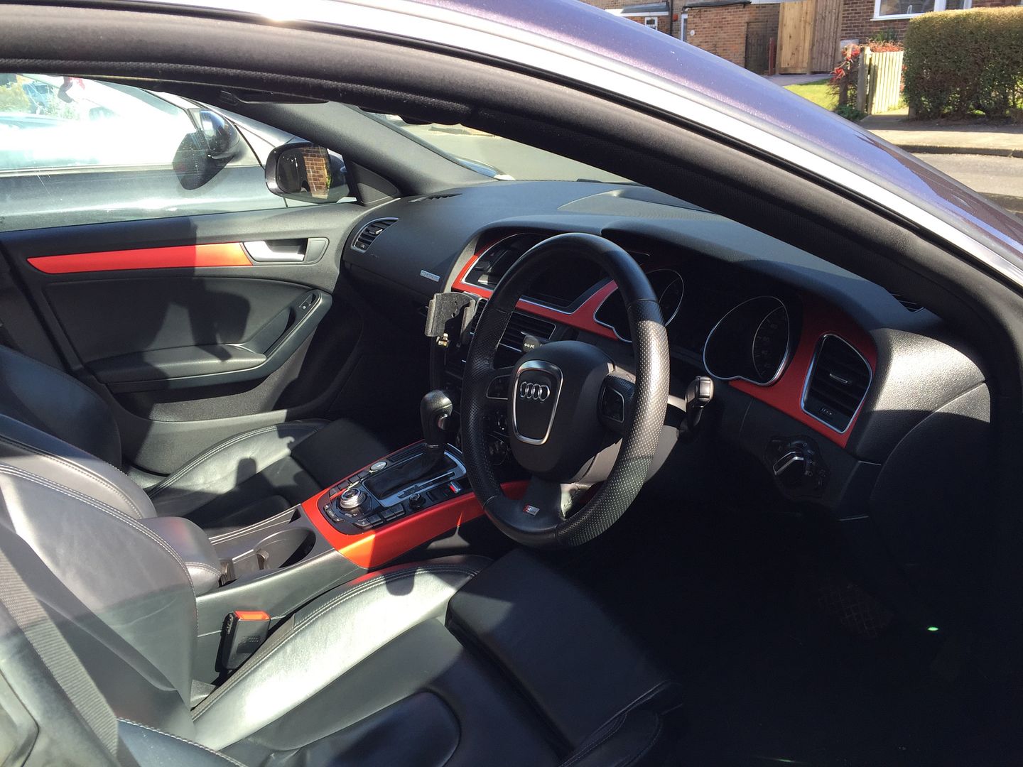

The interior was just too plain and normal for me so i had to put a personal touch to it. So i stripped it down and wrapped the trims in a lovely Satin Red (red is my favourite colour btw)
The pictures honestly don't do it justice, it really stands out and looks the part in the car!

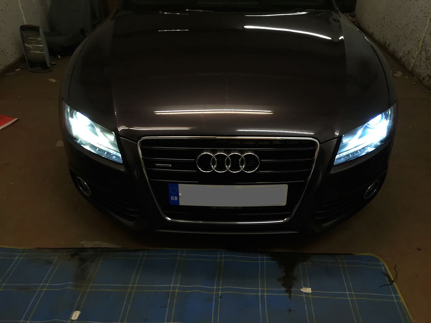

The next thing i did was upgrade all the lights in the car to LEDs, including the 3 lights in the boot. Since some of the lights in the A5 are not the same as the A3 i had to order in a few more bulbs from @t8ups and installed them as soon as they arrived. I also changed the footwell lights from the dim white LEDs to lovely red LEDs so that when I'm driving around at night the ambient light is a nice dim red over the feet.
The next day i had to drop off a customer to Bluewater while i had his car in the garage and as i was walking back to the car the front end of it just didnt look right, it looked.... standard. I had to do something about it so i called up another contact and placed an order for a special part.
I also called up TPS and ordered a pair of Audi LED number plate lights, then got in contact with the guys at HIDs Direct and ordered some 5000k replacement D3S bulbs and foglight bulbs.
Its really difficult to get decent pics of the headlights with an iPhone but here is what it looks like with the uprated bulbs:

Another thing i have done is install Cree LED lights into the reverse bulbs on my A5 however i can't find a picture of my own car but here is one from a customer car I also installed the mod to:
I then invested in these super bright Cree LED number plate lights which are a massive upgrade from the factory LED number plate lights:

And finally i have upgraded the flat bottom to the RS style flat bottom with red stitching and larger chrome paddles.

Shogun
Ash is it a major ball ache to get the aluminium trim off around the gear area?
Can get the door card ones but that one is defeating me
Ash187
Well-Known Member
If you mean the piece that I have wrapped red that goes around the centre console then yes... The whole centre tunnel needs to be removed from the car to get it off since its screwed in from underneath. You need to remove the armrest, the rear vents, the mmi buttons around the gear stick and then a load of screws and bolts come out to let the tunnel come away from the car.
There is a guide around here somewhere that explained how to remove it propery
JG51 AUD
I wrapped my A4 centre trim area without removing, was a bit of a pita but I think alot less hassle than removing it IMO.
It's worth a try before removing the centre trim, needs a bit of patience though.
