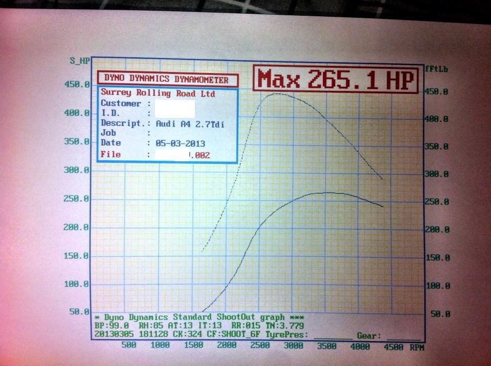

EGT goes off the roof with the small gtb 1756vk on a stage 2 (whatever that means) map ! The best option is to fit the gtb2260vk, I know of one which done 280Bhp with one...

I done this one some years ago with the stock 1756vk.
Held together well about from the clutch but it was driven hard.
