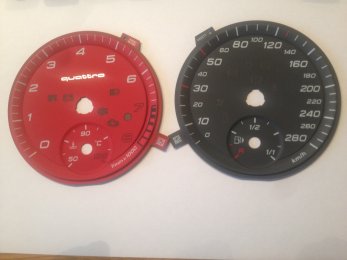

Now the Situation has changed somewhat. I had the opportunity to buy the original instrument cluster discs from the A1 quattro. (see pictures below)
Now I wanted to ask:
1. Whether there is a manual for the removal of the instrument cluster.
2. What I absolutely have to pay attention to
3. How I can get the needles off and mount them again.
4. How I can take out the discs
Has anyone had any experience with this? Can I even do this myself as a layman?
Thank you guys for your tips! Whether it's just in response to one of my questions, all appreciated!

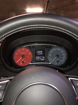

I finally got it done. Actually, the whole thing was not so difficult. But I wasn't careful enough and pressed a needle too hard into the connector. The needle motor was then damaged. I had to open the little motor on the back and saw that it pushed out the spiral that moves the pointer. Fortunately, I was able to fix it and the result is impressive. I am super happy with the result.
Gesendet von iPhone mit Tapatalk
Reactions: Phazer, ZeA38VSport and DJAlix
Here what it looks like.

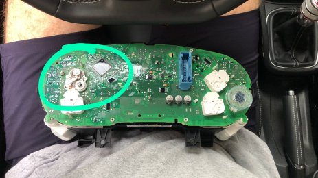

Here a picture of the back of the cluster and its motor I had to repair (top left).
