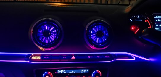

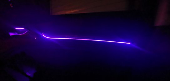

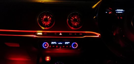

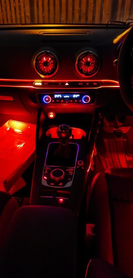

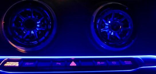

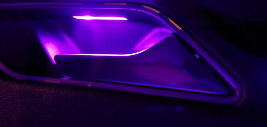

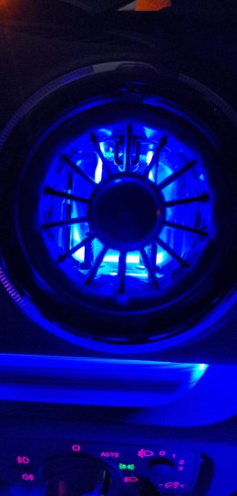

Hi I am wondering if anyone is able to help. I have bought a RGB light kit off AliExpress, that has a controller module with some lights and some subcontroller modules (over Bluetooth) for door pocket/handle lights.
I have managed to wire/code both door ambient light and door handle light and tested that they work fine with Red leds.

The kit is rated 12Volt, under 12Watt and it works fine when wired through power socket/cig lighter. I have tested kit before testing in car with 9V batteries and it works as expected.
