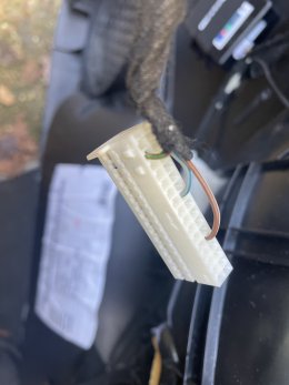

Now poke your head up in the foot well and look up for the bunch of electrical connectors, you'll see a red tab, push that and that will release the connectors.
Now use a torch and look for connector 'B'. It will be a black connector with only 4 or 5 wires going to it. Push the clip in on the connector and remove it from the main wiring block.

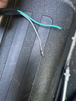

On the back of that black connector there are some numbers which indicates which pin is which, look for the hole number 7, it should be empty, this is the positive feed for the lights, on the side of the plug there is a bit of pink plastic, use a screwdriver to lever it away from the connector, this holds the pins in place, plug the connector of the loom into this hole, make sure it goes into No.7 hole because its virtually impossible to remove the wire from the plug once its in without the correct depinning tool.
Once you are happy with the connector, push the pink clip back into the connector and plug the connector back in to the main wiring block, remember to push the red tab back so it locks the connectors in place.

Now you'll need to get the wiring to the passenger side footwell, i used a coat hanger and from the passenger side pushed it through to the drivers side just behind the stereo and taped the wire to the hanger and then pulled it through.
Once its pulled through you now need to push the connectors at the end of the wires into the plastic plug for the light.
