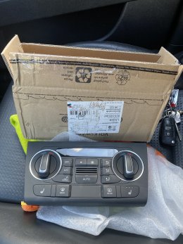

Here is my contribution to the RSQ3 climate control unit
In case people are wondering:
Part number: 8U0820043G
You need to file off about 2.5mm from each side. I suggest you use some tape to trace the outlines and compare heights with the original unit.
Another tip is to remove one of the side handles (see steps 5.2 through 5.4 here). This way you can easily remove and place the unit without damaging the handles when trying to fit. It seems like many people skip this and remove the climate control unit by removing the mid-trim with the coin tray. I tried it as well, but on my vehicle, the coin tray section is fixed on a frame behind the dash and doesn't come out as a unit that looks like a big chocolate bar.
I really wouldn't do this again, unless I have the proper tools. A file will do the job fine, but doing this job from start to finish cost me roughly 2-3 hours.

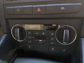

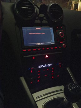

A bit odd that the lights on the dials aren't bright. Any idea if this is a VCDS thing? The unit I bought was basically brand new, with less than 1k km.

Is the only issue the re-circ one? Otherwise it’s shave, plug and play?
what about the change from econ to a/c. Does the light show on when the a/c is off on a pre-fl?
Shave the sides and reprogram 08-HVAC (Adaptation-10) channel 26 to 55 (degrees C) if you have heated seats.

@FPSUsername Seems to me like the brightness of the dials is okay. Even the stock unit has low brightness on dials when you have even a bit of daylight coming in. Compare it to your headlight dial, i belive its gonna be the same story there.
Also, on the side note, kinda jelaous you folk are able to find these units, i cant source one anywhere, and some ebay units are batshit crazy with the prices...
Yeah, it's dim because it's tied to the dash lights. I drove through a tunnel earlier today and they're as bright as they should be (comparable to the other leds and the rns-e leds).

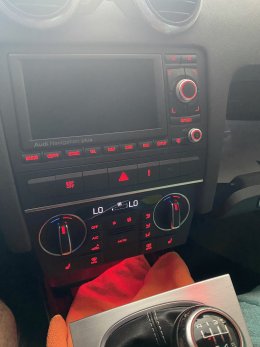

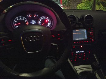

Here are two more pictures in the dark. I put the dash brightness to the lowest (helps with pictures).

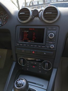

Hello everybody,
Thank you for all these sharing which encouraged me to buy a q3 facelift climatronic :)
Reference : 8U0820043J
But I have an issue, everything works except the AC, when I press the button the red led immediately disappears therefore AC doesn’t work..
I think I need to configure it by VCDS but I don’t know how, can someone help me ? :(
For info my car is an Audi S3 8p Sportback facelift 2009 model
Thanks a lot !
That's weird. The only coding you should do is the adaptation for the level 3 heated seats and turn that down to 55. You can then play with 1 and 2 to fit your needs.
Did you check with VCDS if you get any errors? Try to clear them, often the car generates tons of errors if you replug modules without unplugging the battery, locking out features.

It works perfectly now thanks :)
I just did an adaption on 04 basic setting and I also amended the value for heated seats
