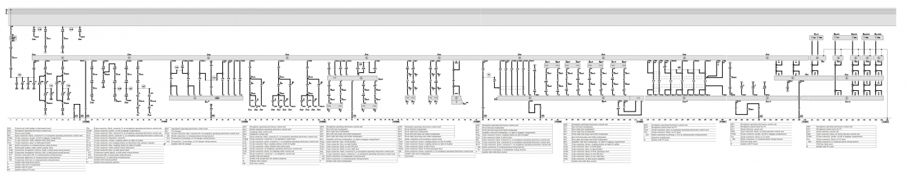

Hi Scott,
have you checked the fuse on the back of the unit ? If the seller started the car by jump starting it then it may have send a power surge to you head unit.
i have narrowed my issue down to a broken power wire in the loom between the head unit and the fuse block, as the radio etc. works when i supply power directly to the power input at the back of the unit. i will add some pictures when i get around to replacing it.
perhaps this wiring diagram might help you in finding your problem

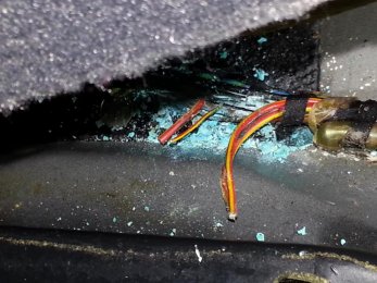

Hi,
I found the problem with mine. I think it's a common issue. Underneath the carpet, under the passenger seat, there is a wiring harness. There are several red wires that terminate in a copper terminal that is covered in a rubber boot.
The copper on my car had turned into green power. Completely corroded to nothing. I imagine it's something to do with water ingress that may accelerate the copper corrosion?
There another post on here somewhere that describes it.
I trimmed the ends of the 5 wires and eventually, soldered them together and covered them in insulation tape.
My radio now works !
I did had to cut the carpet under the seat to access the wires , I couldn't see another a to access them.
Hope this helps.
Scott.

Wow that is definitely some corrosion that has happened over a long period! I wonder where the moisture has come in for that to happen?
