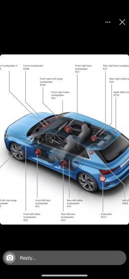

Hello, I’m facing the same issue I don’t have any in the Front Lower Door Speakers and it was very low at the one in Rear Doors but after system rest the Rear Door work and higher than before but the front doors speakers still have no sound in them only base
thats because vocals came only from 4 dash speakers all doors playing low end plus tweeters. this is very bad setup
