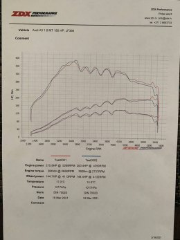

Hello.
My car is Audi A3 quattro1.8t (ARY), that is currently running a stage 1 tune. On the dyno sheet it is clear, that the engine could not hold the boost for long time. The guys at the dyno said it is probably a broken wastegate, but the issue could be anywhere in a turbo. Right now I am thinking about switching to a completely new K04 turbo.

The wobbly lines is more likely related to the haldex... a lot of dynos will show that kind of graph if run in AWD mode on haldex cars
As for the boost.... as Karl said, K03 is out of breath almost as soon as it spools up and your curve looks pretty normal to me for a K03/K03s.... power looks about right too

Hey. The second run was made with haldex turned off. The Haldex fuse was ejected so it should've been better. Am I wrong?
Should have been but looks like torque intervention to me tbh... could also be the map that contributing
