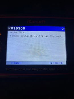

Hello, doing more investigating on my car with the with RPM bounce, I scanned it again and it come up with:
P019300 Fuel Rail Pressure Sensor A Circuit - High Input
With the engine on, I removed the connector and it started to idle normal, so I‘m guessing I have a faulty sensor
To replace, is it just a simple take out and plug and play but just undo slowly to release the pressure?
Once the new sensor is in, will the car fire up after a few cranks, just to build up the pressure again?
Just checking if anyone has done this before, as I can get the sensor today and sort it, just want to make sure I’m doing it right
