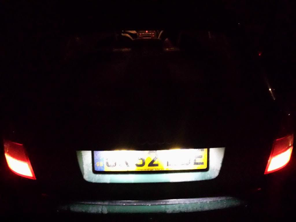

A few pics bit of a difference eh? :yes:
I couldn't find any either Tom, so I just got some of Ebay aswell.
They were easy enough to fit, thanks to Leaky Lloyd for the guide.

My screws where badly seized on so I drilled them out and replaced the lenses and put some leds in. Got new pressed plates on also.
Led on the right.

I bought some LED replacement lights (include lenses as a full unit) off ebay.
My screws are rounded so ordered a new Panel from TPS as well, but it wasn't £27 it was £52 + VAT. :-0
mine was more expensive because it was complete with handle, lenses etc and, I just kept the lenses and bulbs as spares, and used all new for the handle etc, why not.
I used the same eBay LED lamps as scouse, very happy with the results.
