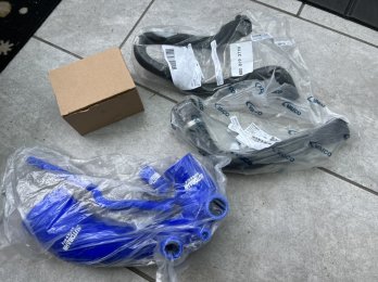

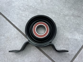

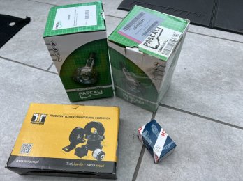

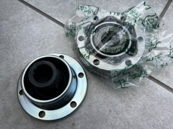

But, a new box from AUTODOC has arrived. With Inner rear CV joints, rear wheel bearings. 4 rear brake hoses, and 4 rear lower hub bushes. So……time to get rebuilding the rear hubs and shafts.

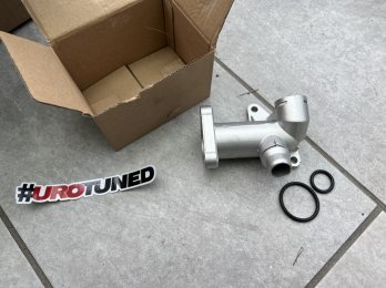

Oh dear……………..so the Audi survived the big trip to Edinburgh and back. But has stumbled at the lesser trip to Saffron Waldon. Probably a tad unfair that, as we have travelled to Diss, then Thetford and Ely day after, then Duxford today.
Noticed the low water light come arriving back to hotel, thought a bit odd, but temps were ok. Lifted the bonnet, no immediate leaking but header tank was practically empty. Poked round at the back and noticed coolant on the gearbox again. Good god, are these rear temp sensor housings a problem on these cars or what?
So, 210 miles from home, plus visiting Silverstone Museum tomorrow. I’ve got 16 litres of water in the boot. I’ll just go really easy, make sure I stop at good intervals to check and refill. See how we go.
My immediate thoughts go back to a fiend who has a Mk1 Focus RS, and they have this problem. The effective mod is to fit an aluminium housing with a decent seal between. So…….thinking I may acquire and fit an aluminium housing to mine. It can’t be any worse!
In pics, yes, my heater hose connector looks cracked, but the connector itself is ok, it’s just this spacer behind the connector which has cracked. If I can find one of those too, I’ll replace that as well.

Put a Febi coolant flange back on now. But I’m ordering an aluminium housing from URO in the states, plus a couple coolant hoses I knew were suspect.

More goodies when I arrived home from the mini-moon.
Box one has prop shaft rebuild parts in it, managed to find the cv-joints for the ends finally at a more sane price. Can rebuild my spare prop now and swap over when we put the exhaust on next month.plus a Genuine fuel pressure Reg. Fault finding the hot start issue…….we’ll see.
Box two from UROTuning in America, contained my aluminium cast temp sender housing. Hopefully this will cure the coolant leak issue that pops up occasionally. Plus some Genuine VAG hoses, top hose, and heater hose connected to cooling flange. And, a new Turbo Intake Pipe. Mine has stretch marks, not liking that. I really wanted a black one, but due to stock issues with Autobahn, I get a blue one. Hopefully doesn’t look too over the top (chavvy).
