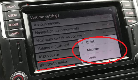

3) Is it possible to adjust the bluetooth volume in the car?
- For example for Volkswagen cars with bluetooth efficiency, can you choose quiet, medium or loud?
--> I think I saw the same in the audi, but I certainly don’t see it anymore. Have I had a dream?

Is it possible in Audi to adjust the bluetooth volume as shown? I think I've seen. (Phone / bluetooth setting area?)
