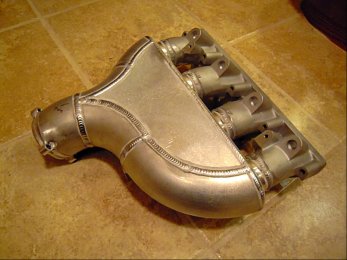

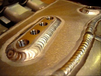

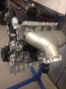

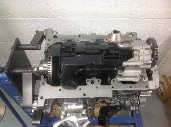

I've had a few pictures of the built engine when it was ready to go in. It was built by storm developments.
One conflict I see is that the seller states its been running this power for around 4 years (so 2017).
Storm developments Facebook page has it down as 2014 when they did the gt30 upgrade, so that's a bit longer than 4 years... invoices will hopefully shed more light on that.
I don't care that its not original. I'm not buying it for appreciation. I'm buying it for something fun to drive (and I love a sleeper). Value Appreciation might be a nice bonus but if it doesn't happen I'm OK with that.
@john13. Yes 440 to 600 is a big difference in cost, but they claim this was built for 600+ and just needs the fueling (secondary injectors connecting) to finish the job, I've not seen any tfsi with secondary injection before. Curious... ...
I will post back when I get the invoices.

So I haven't got all of the info through. It was built in house by Storm for one of the owners at the time. I managed to get a few more details but they will email me the full spec on letterheaded pages for proof soon....
The engine is fully forged with wossner pistons, IE Rods, 83mm over bore, fluid damper, balance shift delete/oil pump mod. Balanced crank Gtx30 ext wastegated. SMFW and paddle clutch.
It has secondary injectors because they were going to put a syvecs ECU on it, but never got to that. So it needs a few grand on one of those and mapping. Or just bigger main injectors and map the factory ECU again.

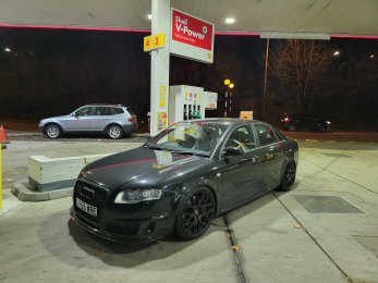

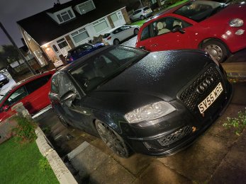

Well it was a long trip. And the drivers window regulator gave up on me so had to have the heaters blasting all the way back (and heated seat). The weather couldn't have been much worse .
It needs a battery too soon. Found out the hard way messing trying to get the window up with the engine off, had to get a jump.
Still enjoyed the drive back. Will get it sorted tomorrow (hope this storm passes soon)
Overall very happy with the purchase.

Its first night on the drive was a bit undignified .
Bin bags and a bit of tape to keep the storm out.
Blocked in by the Mrs fiesta, and the doorbell was set to notify me loudly if anyone came near it.
Managed to get it into a local place this morning, new window reg fitted, new battery fitted. All resolved now.
It needs a good clean and polish next. It was clean when I got it but not now. Let's hope the storm gives us a break soon.
As far as further modifications and more parts. I will just be enjoying it for now. But it's getting syvecs S6 standalone engine management in Summer, switchable maps, low boost, high boost with or without asbo noises.
If a powervalve exhaust comes up at the right price I will get it. This one is a bit noisey and droney at times, you can learn how to manage it by how you drive though. Cruise Control helps.
Bluetooth calls from my Galaxy X Fold 3 were a bit choppy, I might need a newer Bluetooth module, or it mightve been weak battery. Or I may be able to change the phone setup to make it compatible... so that's something to work on.

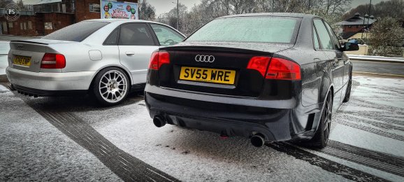

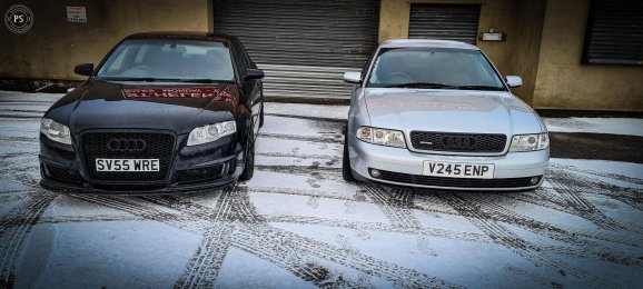

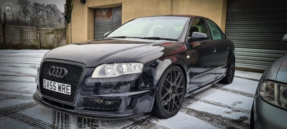

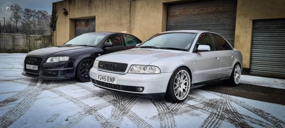

My mate came round for a nosey in his B5 this afternoon.
He took some pics.
Mods - Any chance I can change this thread title to InertiaUK's DTM or something like that rather than start a new one ?
/edit, looks like the trim from around my projector has rattled off.
Not to worry I want to Joey Mod them anyway will get it sorted.

i'll sort that out for you chap.

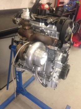

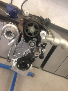

Ok, so a bit of an update on this one is that it does not have a GTX35 on it after all.
@Sandip found an old (ish) advert on here by a bloke called John, I don't know how I missed that! https://www.audi-sport.net/xf/threads/a4-dtm-edition.415791/
I think he had Storm Developments build the engine to his spec, and he didn't like how laggy the turbo was, and being on just the 4 S3 injectors still and the OEM ECU, the trade off for it was lots of lag and only ~450bhp on a short power band so you had to really rev it for any kind of boost (until eventual SYVECS, which never happened).
They decided they should remove the GTX35 and install an 'Owen developments GTX2860r' which produces close to the power figures, but boosts from low down the rev range. and map that in on the stock ECU So that's what happened making the car much more drivable.
Apparently (wating for John to confirm) the GTX2860r put in it has a special (Brass I think?) stronger core, which means it can handle being spanked a bit. So based on that, storm can still do SYVECS on it, and get some more decent power out of it, although I'm yet to learn what that might be. I guess we find out on the day if I do it :superman:.
They have kindly sent me the lightly used GTX35 which I have now (arrived just now) if I did want to use it, but from what I've heard/read I'm better off just getting what I can out of the 28.
Nobody is really at fault here btw, its one of those things, the car was built as it was advertised, then it just got lost along the way that the turbo had been changed. And they sent me the one advertised, so no problems at all.
Its not changed my opinion about the car, and if I sell that GT35 turbo (which are £1700 new) that's around a grand less its cost me, taking it very close to the price of a standard clean one! When I look at the big picture, its a good thing it all went down like this. I wouldn't want a laggy car, and its further cost savings, so meh.

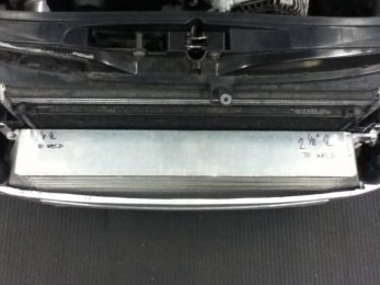

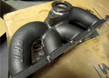

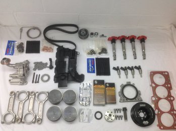

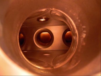

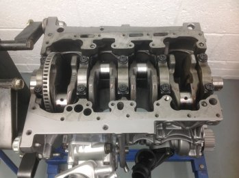

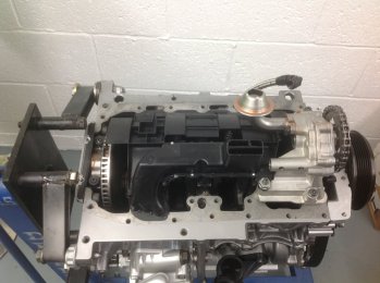

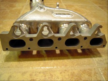

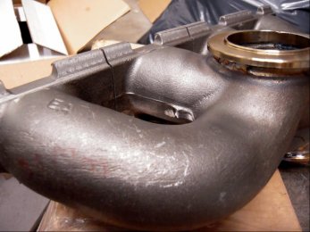

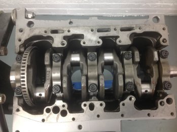

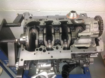

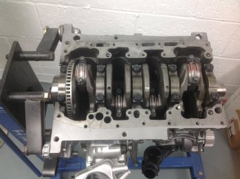

I was supplied some pictures of the engine build itself, just to give me confidence that its all nice and strong...

wowcher, pics are always worth their weight in gold with mods. :yes:
Some good work on that engine.

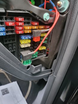

I spent Friday afternoon and night playing with my new toy... after 1 week.of ownership and no time to play...
I started getting ( ! ) brake warnings intermittently, only on the odd occasion and it did that horrible high pitched 'somethings broken or you need fuel' beep. Flashed up on DIS the went away in a few seconds.
Did some electrical investigating and found it had 2 fuse spurs.
1 to make the fuel pump always run full rather than on demand from the ECU, and the other one was in the 'towing connection' fuse to some yellow wires going into the dash.
A quick WhatsApp to @j4jon and it turns out it had column mounted guages at some point. the yellow one was to power them and the wires are tucked away now.
I wiggled the wires and the DIS gave that warning, they were earthing I think where they had been tucked away so I unplugged the spur and replace the fuse, that fixed that little gremlin.
