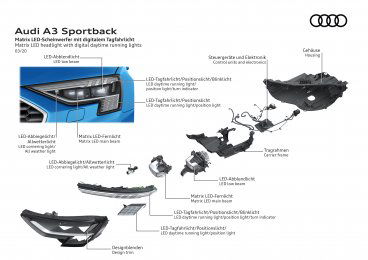

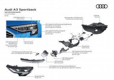

If you look at the attached diagrams they are almost the same apart from the matrix light for lighting certain sections of the road and the signature day time running light
