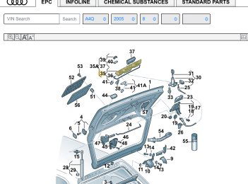

Question re number plate lights/bulbs. I want to improve the dull and poor halogen ones with some brighter ones from EM Tuning.
Now I know you need to remove the boot lid trim so warning triangle out, screw in handle out, gently pull the trim away. But for the life of me I cant seem to see where the loom/plugs are for the actual back of the light module. The one I can see is the boot lock actuator. Anyone know how to find it, is it on the left side as you look at it or the right side ? cheers
I just unscrewed the lens one side and it drops out
are you talking about the black light section ( once the lens is removed ) that sits in the slots, the one that has the two metal plates that contact with the metal springs of the light fixture ? didnt see if they could be unscrewed. All I need to do is to get to the wiring so I can add in the inline resistor that EM tuning provide to stop any canbus errors.
Its this thing I am trying to fit

sorry still dont get it ... when I remove the outer clear lens that holds the bulb ( single screw ) I am faced with a moulded connector unit with two small metal pads . There are no cables visible ... which is why I thought the cable is visible from inside the boot. On all my other cars, you take out the outer lens and the cable is visible, not on my audi hence the question.
Reactions: northpole
Pull out the black housing once you remove the lens... a whole new world back there for you to see ;)
couldn't make it easier as someone took the time to show hw to remove the licenseplate bulb housing completely ;)
Sadly what you linked to is not what I see
In the end I was right about removing the trim and have got it sorted
So maybe there is a difference between model varients after all
No you just went the long way about it... but you got it sorted lol
I will take a photo at some point and you will see what I have and what you linked to are different
The cable goes into the same cable that does the lock which at first made no sense
Well blow.me down all the way up there? You should've gone for the ones we have, way easier and just an unbolt, replace bolt on job. As easy as the welcome lights in the doors.
I’m with you ….. there’s no way of getting to the wiring for the bulb holder without taking the inner trim off the boot. It’s one piece which includes both bulb recesses and the boot release part too, and is screwed on from the inside, 8mm nuts from memory. The wiring connects in to this part..
I did it without removing the inner trim but I got the ones that come with a complete housing and the error cancellers are integrated inside the housing of the led units... easy as unclipping the oem halogen housing(remove bolt than unclipped oem housing, just like in the video) than the connector comes down with the housing. Same goes for both. And I have big hands, and swapped them both in 5 minutes. And I'm quite sure it was the same for @Jamsmoo.
Again the whole license plate light housing comes out by itself if you unclip it. And with it comes the oem connector to it... Now I'm not sure if that cable would connect up to the connector on the housing but if it does you gave yourself more work.

finally someone who gets it. I knew I wasnt going mad as when you look at the assembly you can see the lock mechanism and both number plate bulb holders are all one piece. Anyway after speaking to Trup he explained that the inline resisitor they supply does in fact use the lock mechanism to tie into . which intially was why I was confused as when I plugged it in the boot started making locking/unlocking noises. But seems that is how it works. Anyway all back together now and seems to be working..time will tell as the little metal prongs that bend and make contact with the metal pads are very sensitive to get into the correct angle.

Well see this is why you needed to open it up the cable does not connect to the light bulb housing but inline further up the stream....
Next time make your life easier and just get those things both Jamsmoo and I have lol

that is all well and good saying get this part etc but I was trying to solve the problem with the part I had already. I totally get that the parts you both had was a lot simpler but the confusion seemed to be that what you have ( as in the boot lid layout ) is different to what myself and Gmac have. Which makes it even odder as how can two models of B7 be so different on such a simple item.

It would not work as the item you linked to needs a cable to be visible and Gmac and I dont have that ..simples

What does your oem housing look like ?
A bit like this . You can see the two sections that house the number plate plights are moulded and in this pic you can see where the cable goes into the lock mechanism
Screenshot 2024 04 17 at 093214
and this is the oem bulb holder showing the metal prongs that connect to the metal pads
Screenshot 2024 04 17 at 093233
I just went out and rechecked mine.. it is the exact same as yours... but the black part comes out. After you have removed the lens and halogenbulb...And after another check online the A4 b6 b7 b8 and the a6 c6 all use the exact same registration bulb holders and housing. I'll do a deep search in etka and report back.
I just did a search in Etka... there are only 2 part numbers... one for the left the other for the right light aka they are the same across all the variants of the b6 and b7.
But as I said before you got it working and that is all there is to it.
PS i got these not the ones you put a picture up off (checked my purchase history)
really odd then because believe me that black plastic housing is not coming out unless I take out the entire housing including lock. Must be different on avants is all I can say
