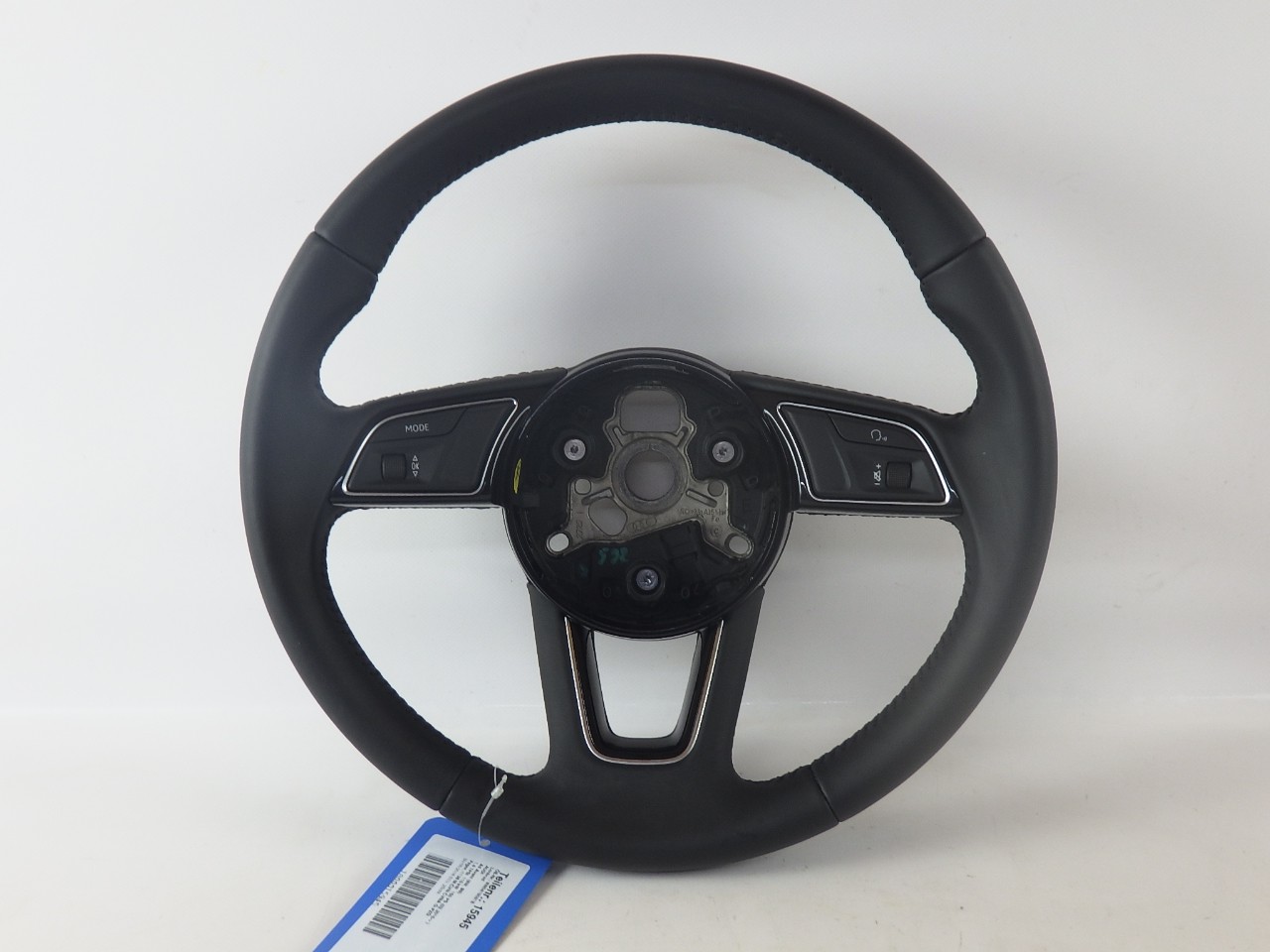

Would anyone know if 8W wheel (photo below) could be fitted on 8P? To what I found it uses dual stage airbags on A4s/Q5s.
Should be fine it it’s used on a4’s, it has the correct buttons that you need. You’d still have to repin the airbag though
